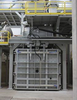

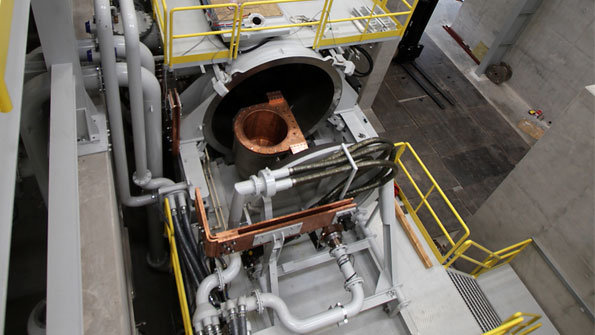

The 1-metric ton copper crucible and melting chamber door of AMRC Castings centrifugal casting installation for titanium aerospace engine and structural components.

The new furnace has three interchangeable crucibles sized to melt 250 kg, 500 kg, and 1,000 kg of metal: this flexible set-up gives AMRC Castings the versatility to produce components with a finished weight ranging upwards from 60 kg.
As explained by AMRC, a volume of molten titanium in excess of 1,000 kg is required to make a 500 kg titanium casting, and there are only a handful of furnaces in operation anywhere in the world that are capable of casting near-net-shape aerospace components of that size. In short, the flexibility and scale of the manufacturing system is a critical factor in its potential for success.
