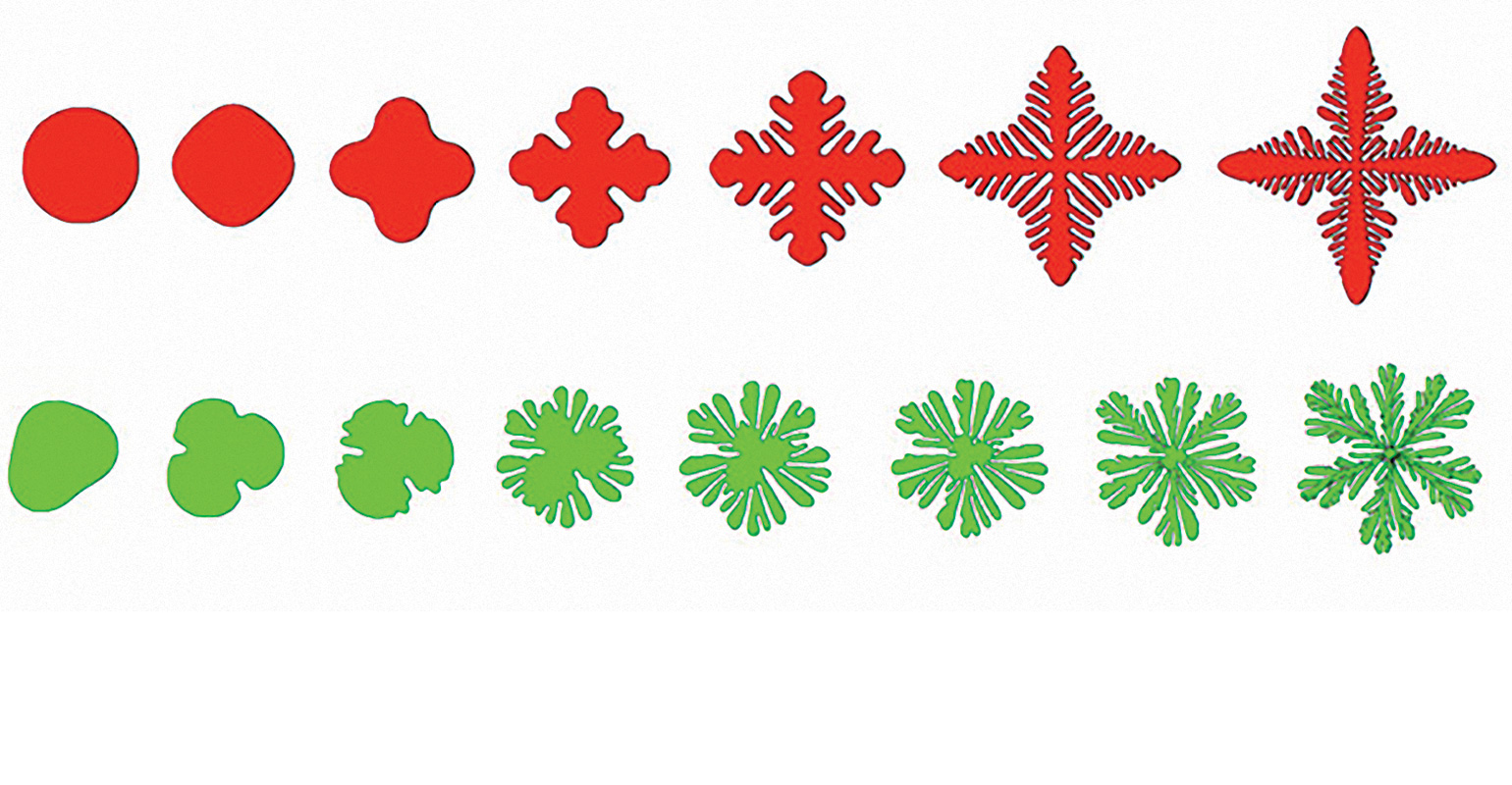

Glicksman, working with Kumar Ankit at the School of Matter, Transport and Energy at Arizona State University, reviewed data he collected two decades ago in NASA experiment involving repeated freezing and melting of high-purity materials in microgravity. The data reveals new information about naturally forming, complex patterns in materials that crystallize.
According to Glicksman, there is an energy field that influences all crystallizing substances. He calls this “the bias field,” and he contends that it is an empirical guide to the development of cellular and branching dendritic microstructures that form during solidification of most metals and alloys.
“In the last phases of melting,” Glicksman reported their observation, “needle-like crystals suddenly changed to spheres, and so for the first time ever, as we watched stationary particles melting in microgravity and observed their rather remarkable shape change, … There must be something more going on than just noise.”
Glicksman and Ankit reported that what they detected is “a subtle internal energy source” (i.e., the bias field) that modulates the speed of the solid/liquid interface on small scales, and ends up creating remarkably complex structures. Their finding has been confirmed theoretically and though advanced simulation methods.
“We were fortunate to perform experiments in microgravity, where the bias field idea was initially suggested to explain the occurrence of unusual melting patterns,” Glicksman stated. “Now we have a sound thermodynamic theory and proof to back that idea up.”
Glicksman and Ankit published their discovery proving the existence of bias fields in the journal Metals.
