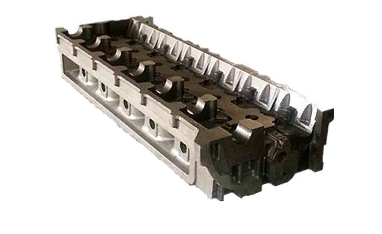

A Chinese foundry is adopting SinterCast compacted-graphite iron technology for its production of 12.7-liter cylinder heads, for heavy-duty trucks. SinterCast will deliver its Mini-System 3000 and a wirefeeder system, which will be installed by midyear at the foundry in Hejin, China.
Shanxi Sanlian Casting Co. Ltd. is a specialty supplier of engine blocks and cylinder heads for passenger vehicles and commercial vehicles. The cylinder heads are already in series production, as gray iron castings.
