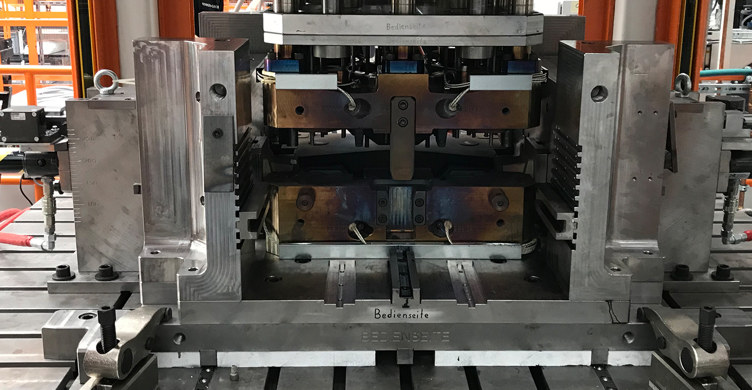

![A new, low-pressure casting machine installed at IFAM’s research foundry in Wolfsburg, Germany. [Fraunhofer IFAM]](https://img.foundrymag.com/files/base/ebm/foundrymag/image/2021/05/0_0521TecDev_Ifam_LPdiecasting.60a145202d2fa.png?auto=format,compress&fit=crop&q=45&h=139&height=139&w=250&width=250)
