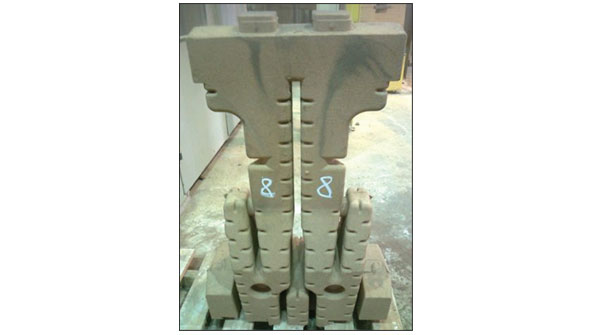

The primary objective for the Usiminas foundry was to optimize the process conditions for an existing tooling layout. One particular core, called the thin waist core, represented some of the biggest challenges for Usiminas: its length (920 mm), substantial changes in the sand flow direction during blowing, the need to fill certain parts of the core through counter-flow, and big variations in the cross section within the core, undermined the consistency of the coremaking process.
Figure 4. Total gas mass flow through the lower vents. The change in mass flow becomes clear. Removing some of the upper and middle vents resulted in a 36% increase in the gas escaping through the lower vents. (Image by courtesy of Usiminas.)
First trials showed problems with the process, which led to a complete collapse of the lower part of the core. The core blowing and curing steps for the PU coldbox process were analyzed, making it possible to draw preliminary conclusions about the defects.
The lack of core strength was related to a poor curing process. The first simulation showed that the problematic regions experienced only very low curing gas concentrations during gassing, and this was identified as the root cause for the failure.

The optimization led to a considerable increase (~36%) of the curing gas concentration in the lower regions of the core.  Also, the amount of adsorbed curing gas increased in comparison to the original project. Applying these modifications, Usiminas produced another core, which showed no gassing defects. Because the venting area was reduced, some filling defects were present, as expected.
Having solved the curing-related defects, the engineers conducted a further core-blowing analysis. The simulation results showed a very good match between the real defects and areas of low packing density. The flow animation also showed that the problems occurred because these areas had to be filled by a counter flow of the sand.
Figure 5. Core blowing defects are more prevalent in the areas that are last to be filled, and are only filled by a counter flow of sand, which prevents good packing. As the defects occurred in areas next to the parting line, it was suspected that the core box was not properly sealed. (Image by courtesy of Usiminas.)
Another characteristic of the defects was that all of them occurred next to the parting line of the core box.  Some of the defects showed a smooth surface, indicating that sand had been removed by a strong airflow. Core-blowing simulation results supported Usiminas’ conclusion that an improper sealing of the tool was the root cause for these defects. Air could escape with high speed through the parting lines, resulting in the defect formation.
This hypothesis was tested using a silicone rubber band to obtain an improved sealing of the relevant areas of the tool. With that modification, a new core was produced that was entirely free of defects.

Figure 6. A defect-free core. (Image by courtesy of Usiminas.)
