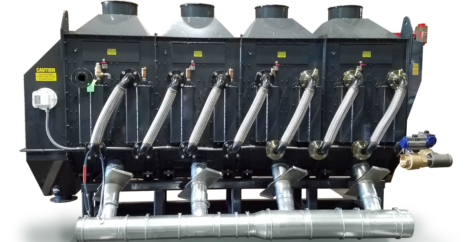

Many foundry managers and operators wonder about the possibility and/or effectiveness of using a fluid bed classifier to remove airborne sand fines. It's possible, but removing sand fines through the classifier depends on several process details.

Generally, a classifier will have a 4-ft.-high expansion chamber immediately above the classifier exhaust connections. The diameter of the chambers is sized to reduce the exhaust air to a velocity of approximately 750 fpm, allowing coarser sand to drop back into the classifier.

2.  Fluidizing air volume. The design detail that controls the volume of fluidizing air is the open area of the blower inlet blast gate. Plugged fillers on the blower inlet also will reduce the fluidizing air. Individual blast gates below individual modules can redirect the flow of fluidizing air, or stop it completely if totally closed. Once the classifier is filled with sand, the inlet blast gate usually is adjusted until the sand is bubbling about 6 inches in each module.
A higher volume of fluidizing air will cause the bubbles of sand to be higher and drive more fines into the head space. So, the exhaust system will extract fines along with some larger-sized particles.
3.  Exhaust negative pressure. Increasing the fluidizing air will drive more fines into the head space, and with adequate exhaust it will remove more fines. Once all modules are bubbling properly it is necessary to adjust the exhaust using the blast gates above the expansion chambers so that there is some measure of negative pressure in the head space. Generally, -0.6 inches of water column is acceptable for silica sand. Higher-density sands may require more negative pressure, which will remove more fines.
