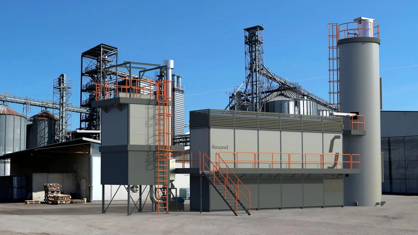

Resand Ltd., the developer of a foundry sand reclamation system based on electricity and emphasizing modularity and environmental compliance, inked its first “sand as a service” agreement earlier this year. The treatment unit installed at the Valmet Jyväskylä, Finland, iron foundry is regenerating molding sand for that operation, cutting its reliance on virgin sand with minimized environmental impact.

The two-stage Resand process starts with a heat-treatment cycle to remove binder residues from the molding sand, followed by a mechanical drum sequence that separates any other impurities. It reports the process can clean 1,000 kg of sand per hour, material that provides 95% of the mold strength of virgin sand.
In addition, Resand claims that its regenerated sand can reduce a foundry’s sand-purchasing and disposal costs by 10-20% annually, without any major capital expenses. And they further note that their process reduces CO2 emissions from sand use and transport by up to 80%.
For onsite installation at metalcasting operations, Resand describes the treatment unit as “a modular system that is quick and customer-friendly for the foundry to install and commission, with a delivery time of only 4–5 months.”
