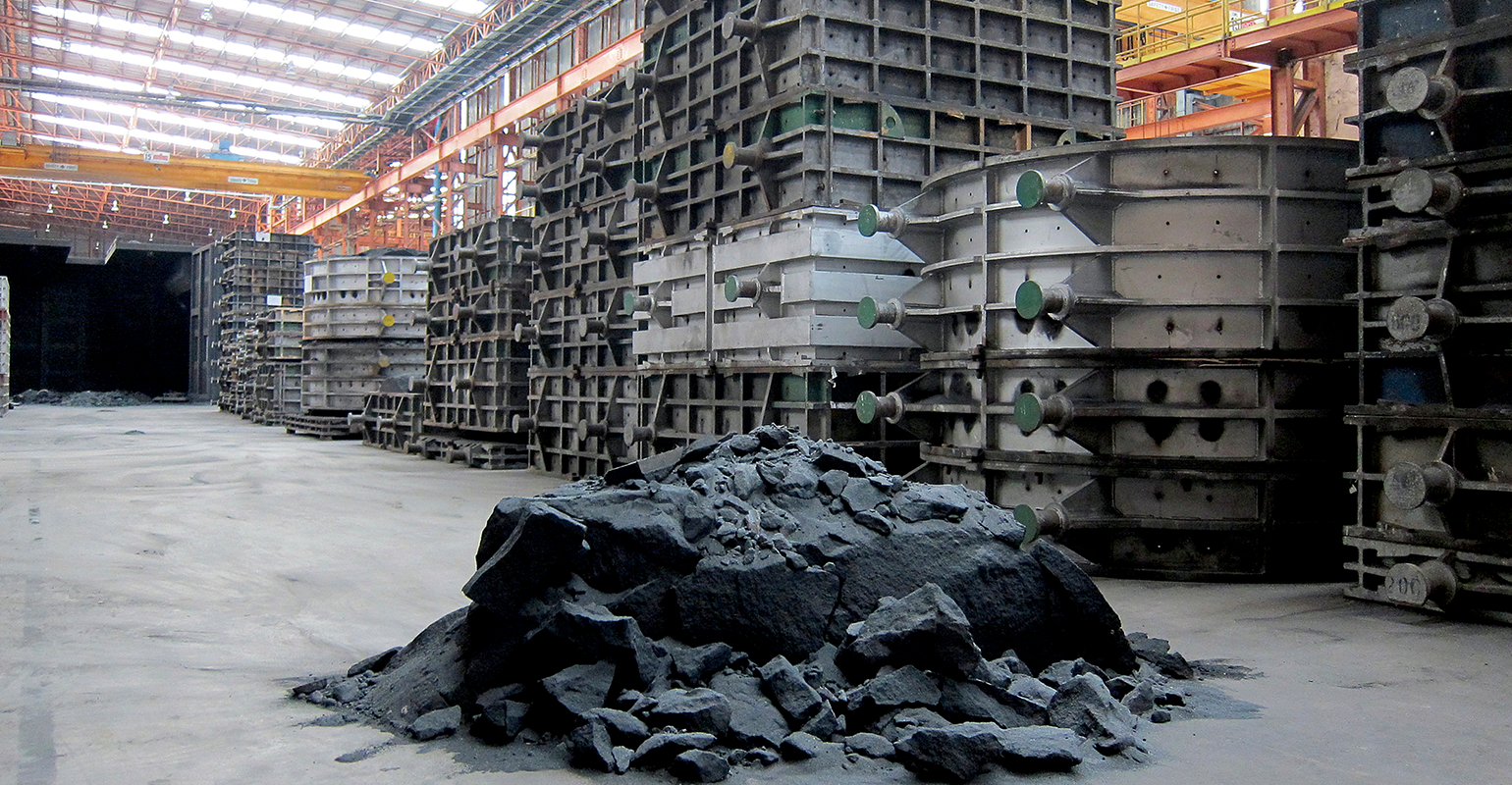

Many people have the impression that “sand” is an infinite resource, but metalcasters know that’s deceiving. Sourcing the right sand for a molding and coremaking program is basic production cost and frequently a sourcing problem too, as different grades offer different mineral or mechanical qualities. Sand is essential, but it can be a considerable expense.
"Availability of new foundry sand is already becoming a challenge, along with the need of providing new solutions to waste management,” according to the manager of a European metallurgical research center.
Sand that seems to have no further value to a foundry, spent bonded sand, can be an expense too – and worse, a liability. Rotary and vibratory systems that clean and recover molding sand are basic operating systems for most sand casting operations, but lately foundries are being presented with new options, and new imperatives. The difficulty of disposing of bonded sand in any affordable or acceptable way has brought forth new ideas in sand treatment and recovery.

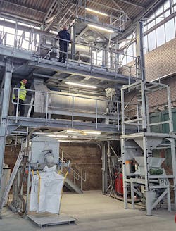

Last year a German business, FSP Foundry Sand Processing, commissioned a pilot plant for wet-reclamation of inorganic-bonded sands, and makes it available to foundries for testing their own sands’ suitability for recovery. The Stuttgart, Germany, plant performs a wet reclamation process patented by DEANTEC GmbH for “water-glass bonded” (i.e., sodium silicate) foundry sands and special sands from 3D printing processes. It’s described as “highly energy-efficient and close to carbon-neutral” process with a throughput rate of one metric ton per of sand per hour.
The sand is not dried with heated air; rather, water is converted from liquid to gas using energy recovered from the condensation stage. Dust particles are removed in a patented fluid-bed cooling separator.
Process water is treated and maintained in a closed circuit. One metric ton of sand generates just 12 liters of wastewater, which represents the only freshwater requirement. Because the distillate is fully demineralized, it is better suited to washing the sand than fresh water.
Also, during the distillation process, condensation energy is recovered. Nearly all (95%) of the energy required for evaporation is recovered from condensation.
FSP’s process removes contaminants from used sands with 98% effectiveness, so the reclaimed material will have nearly equal mechanical strength and flowability as new sand. According to FSP, this means foundries can use it to fulfill up to 95% of their “new” sand requirements.
Compared to mechanical sand reclamation processes, the FSP process is claimed to be gentler to the material. Binders are removed without damaging the grains, and the process is practically dust-free. The fine-grain fraction of the reclaimed sand is less than 0.3% percent, according to FSP, meaning there will be no additional costs for dumping spent sand.
