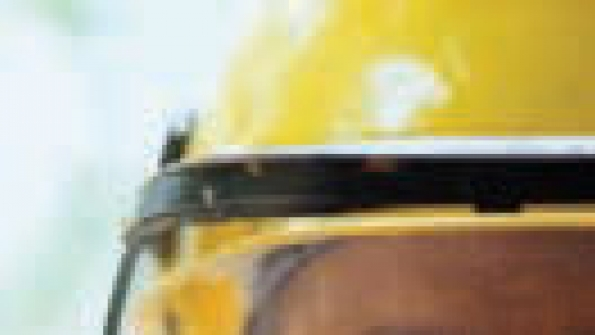

Head — Hazards that cause head injuries include falling objects, moving equipment and/or overhead obstructions, as well as burns from physical contact with molten metal splash, sparks, flames and/or hot surfaces. To prevent these types of injuries use hard hats that meet American National Standards Institute (ANSI) Z89.1 standards.
