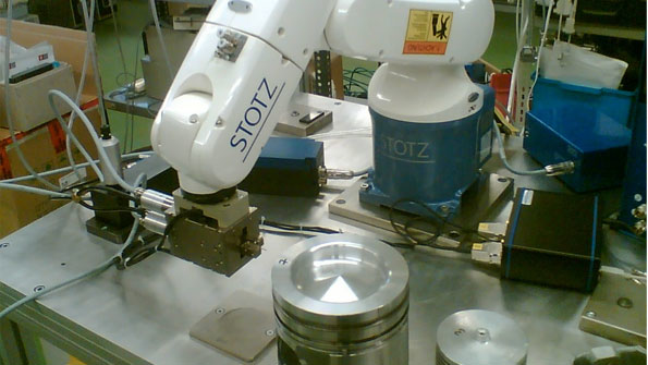

Air gauging can be used to measure complex geometric tolerances, such as diameter, taper, parallelism, squareness, flatness and matching of components in a very fast and efficient method. These may not be able to be checked with fixed limit gauging or may be costly and time consuming to check in a different way. The size of probes continues to get smaller and smaller and can now be as small as 0.6 mm (0.024 in.) in diameter.
Many of today’s columns and/or measuring computers can become an integral part of the manufacturing cell with communication to robotic loaders and the ability to send offset values to the machine, which allows for around the clock manufacturing with 100% inspection of workpieces.
