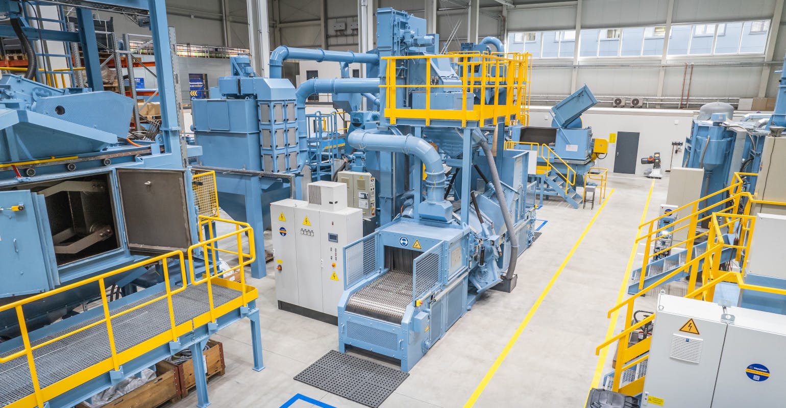

Wheelabrator – one of the businesses comprising the Norican Group – recently completed an $85,000 (€80,000) investment to improve the metallography capabilities at its Technology Center in Metelen, Germany, to advance its understanding of wear parts for surface-preparation systems.
Wheel-blast wear parts are a focus area for the research center. “They present the fastest route to lowering the running costs of customers’ wheel-blast processes,” according to Wheelabrator. That explains the need for greater insight to wear behavior, and thereby the metallography for such parts.
