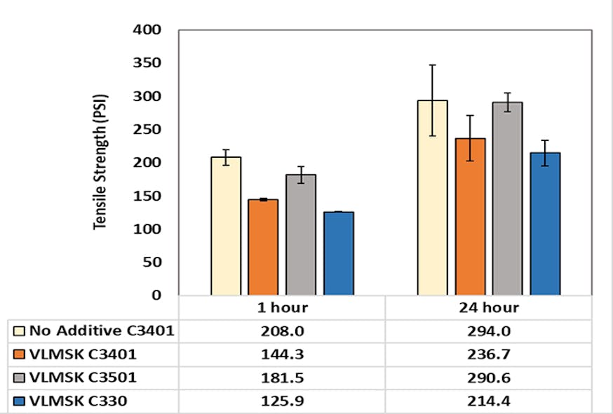

When working with most sand additives, it’s necessary to increase the amount of the binder being used in order to compensate for a decrease in tensile strength that results due to the addition of high-surface area, finer particles. VEINO ULTRA NB-LOSMK’s size distribution has been optimized in order to minimize the negative effects on tensile strength.  (See Figure 2.)
