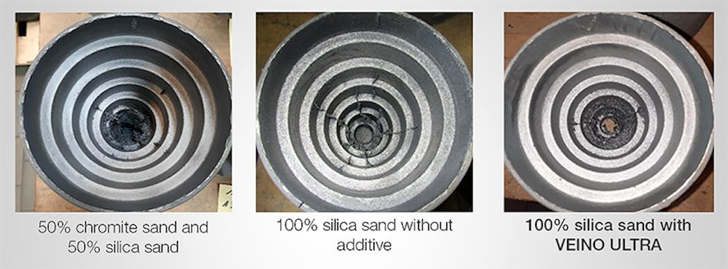

Special sands are natural mineral sands, sintered and melted products that are produced in granular form. They differ from silica sand in particular in their significantly lower thermal expansion behavior in the temperature range from 20° to 800°C. In the casting process, special sands such as chromite sand, ceramic hollow spheres, andalusites, and feldspar sands are used. The quantities added (usually 30-100%) vary greatly depending on the specific requirements.
Alternatively, with a few exceptions, they are not reclaimable/separable and they generate high disposal costs. Above a certain level of accumulation, the use of special sands also may negatively impact the green sand system. Plus the cost of special sands can fluctuate widely. Unfortunately, in many cases those costs are accepted (see Figure 2), because no alternative is available to achieve the desired quality. The following example shows that it is possible to replace chromite sand without sacrificing casting quality (see Figure 3.)
