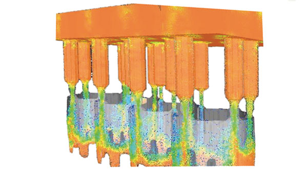

On the other hand, Arena-Flow is a multi-phase computer program that uses two separate phases for the gas-particle flow.  For reference, the first phase is called the “fluid-phase” and characterizes fluid properties — any shear stress induces motion.  The second phase focuses on a separate particle, or “granular-phase.”  In this instance the particles can support a finite shear stress without motion.
Arena Flow is, in fact, the only foundry software originally designed to account for discrete particle flows, including both the solver and grid generator.  The numerical equations are solved on both a eulerian (fixed) grid (i.e., fluid phase) and grid-less, Lagrangian formulation (i.e. discrete particles.)
To review, the main differences can be summed up in three points:
1.  Arena-Flow treats particles as discrete entities.  Traditional continuum flow software does not.  Rather, it assumes any particle at rest, or moving, is a fluid.
2.  The user can specify precise information on particle size and density distribution.  This allows for accurate density prediction and core sand compaction.
3. Arena-Flow, using the Lagrangian method, properly accounts for particle-wall collisions, as well as particle loading that allows it to model any type of CAD.  In other words, you don’t have to tune the model for each specific core.
