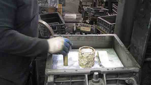

An EXACTCAST™ Floating Cover Lid, which replaces the need to apply a powdered hot topping to open risers. They developer explains they perform more consistently than standard hot toppings because of the predetermined size and weight of the cover lid. The thickness of the lid is designed in proportion to the diameter of the riser. They are typically placed inside the feeder when the mold is closed and float up as the riser fills the molten metal.

Now, to the question of what alternatives may be considered, more efficient and consistent options do exist.  ASK Chemicals produces EXACTCAST floating cover lids that offer major benefits to traditional hot-toppings.  Made via a patented cold-box process, their diameters are sized to fit inside open risers with consistent thickness.  Therefore, you’ll have maximum coverage and optimal thickness for every riser, no matter its size.  These features will help you see a flatter feed from the riser, thus maximizing its efficiency.  Also, because EXACTCAST floating cover lids are pre-formed, foundries are able to position them inside the open riser via nails, or by simply setting them inside a neck-down riser.  As the riser fills with metal the cover lid will float to the top, all the while insulating the open riser.
The EXACTCAST floating cover lids are an extremely reliable solution and are recommended for any foundry currently using traditional hot-toppings.  ASK Chemicals offers these in insulating and exothermic formulations to meet your particular requirements.
