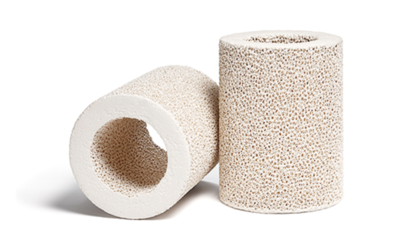

Fortunately, a better design is available.  ASK Chemicals Hi-Tech LLC recently created the only cylindrical filter for large steel and iron castings.  It features 3X greater filtration area, accomplished by its one-of-a-kind 360˚ design.
Durability is the hallmark of this new filter.  For instance, the inlet / outlet diameter is 3 in., making for an extremely strong filter wall.  Of course, the most significant aspect of this new offering is in its shape.  The cylindrical design will withstand considerable force from the pressure of the pour because it can distribute the weight.  Thus, breakage by force is essentially eliminated.  Even the end faces are protected from breakage by an edge coating to ensure against leaks and breaks. This provides foundry operators with the assurance that their filtration practice is safe and efficient.
This new UDICELL tubular filter comes is packaged in its own customized ceramic housing unit, developed to seamlessly encase the filter to protect against metal by-pass.  In total, the entire package is composed of only three parts: the ceramic housing, the tubular filter, and the lid.  This incredibly durable and compact offering is easy to handle and assemble and only requires one filter per unit.  In many cases, this single unit is all that is needed to filter several tons of steel and/or iron. Considering your situation this would certainly be a possible solution to your problem.
