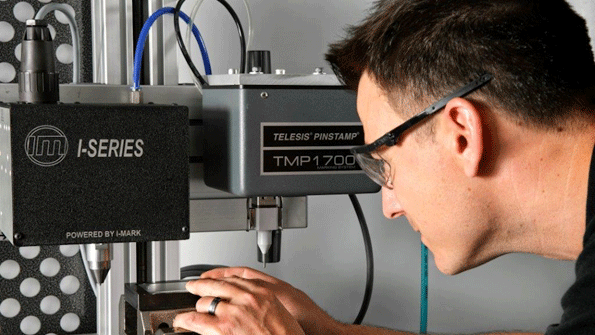

COLUMBIA MARKING TOOLS' I-Mark™ I-Series (Integration) dot peen and scribe marking systems offer maximum flexibility with standard features that typically are offered only as premium options. The systems are effective for a wide range of applications and materials, and are designed specifically to integrate into automation systems.
Two versions of the I-Mark I-Series are available: the standard dot peen model and the “Silent Scribe” versions.  Both will mark at speeds of 4-5 characters per second, including 2D/UID machine-readable codes.
The Silent Scribe model also marks CMT’s patented, high-resolution Square-Dot® 2D code.  With three mounting sides to choose from, these systems fit easily into production equipment.
Optional features include small and large marking windows, an additional debris shield for industrial environments, extended pins for marking in recesses, and extra-long cables to position the controller farther from the marking head.

The I-Mark I-Series marking heads and controller are designed for 24/7 use.  The head has a solid aluminum frame for durability, and high-torque motors help assure precision marking in any orientation.  The NEMA 4 controller offers a wide range of communication options and has four mounting holes for quick placement in automation.  I-Mark I-Series Integration Systems are easy to program and provide reliable marking for automated applications.
