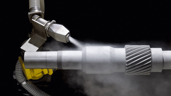

The system's cleaning performance is the result of the interaction of saturated steam with a high-velocity airflow. As the steam jet exits the nozzle, it is enshrouded by heated air accelerated to a very high velocity, and thus focused directly onto the surface to be cleaned. Any intermixing between the two media is prevented by the high-velocity airflow, and the properties of the steam.
For an optimal cleaning result the moisture content of the steam can be accurately adapted to the cleaning task or specific contamination type. Thus, for removing oil, wet steam is applied to modify the oil viscosity so that the oil will be atomized into ultra-fine droplets. These are then blown off the part surface, along with particulate contaminants, by the airflow. Drying is provided by the high-velocity airflow too.
