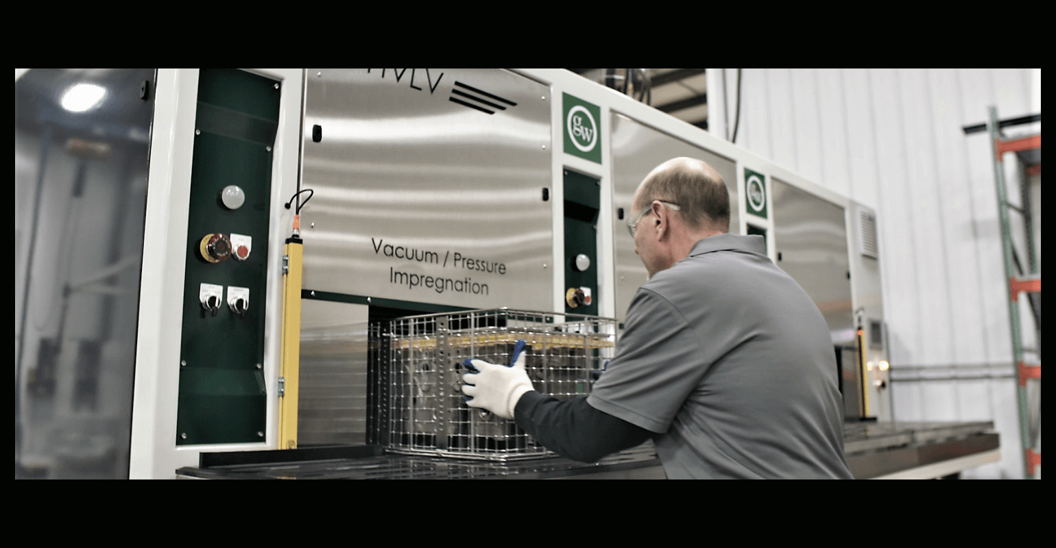

The solution — The plant operators realized that the current vacuum impregnation system would need to be replaced with a modern impregnation system. Based the challenges, Godfrey & Wing recommended a customized installation of its Continuous Flow Impregnation (CFi) system.
To improve the sealing rate, the CFi uses the patented Dry Vacuum and Pressure (DVP) process, which yields a higher seal rate than the DV process. The CFi with the DVP process incorporates a fast, deep vacuum to evacuate the air from the porosity. Then, after moving sealant to the part, the system applies high pressure to allow the sealant to penetrate deep into the casting walls.
The OEM specified precisely where to place the system on the manufacturing floor. Knowing this, the Godfrey & Wing engineering team designed the layout to accommodate the floor space and production integration.

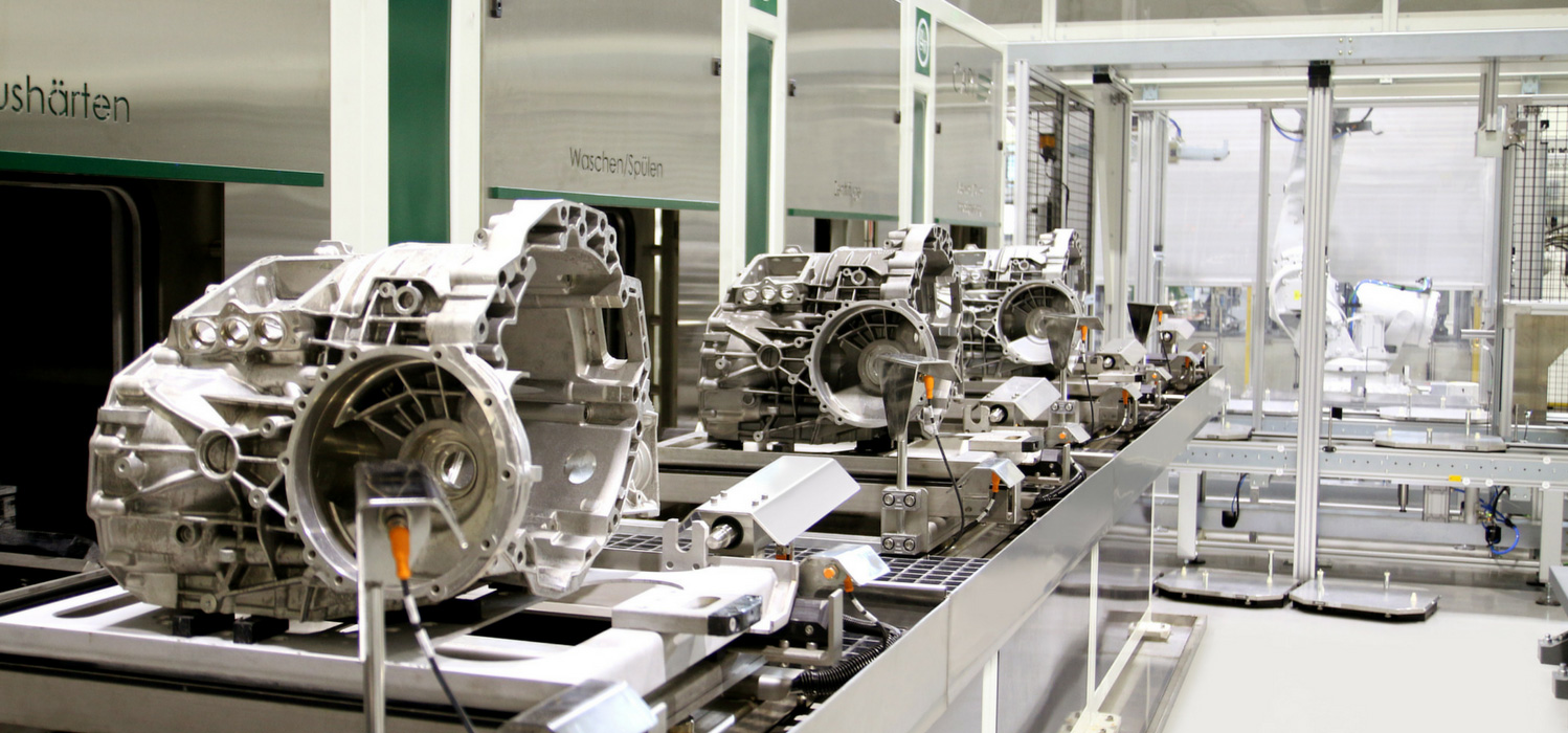

The system was designed with a 7-axis robot for parts handling and conveyors integrated with machining and leak-test operations. The robotic arm forms the interface between the impregnation system and the processing line, while occupying the least amount of space. After impregnation, the castings are fed by the robot directly to leak-testing via a cooling conveyor belt. The automation enables continuous production in a modular, compact space.
The internal components were positioned to enable ease of maintenance without interrupting production. The maintenance team is now able to service principal components through the rear panel doors, rather than accessing the system through the safety fence. Sanitary connectors are used that can be maintained by hand without the need for specialty tools. Each module has a line rate disconnect so that maintenance does not need to power down the entire system for service.
