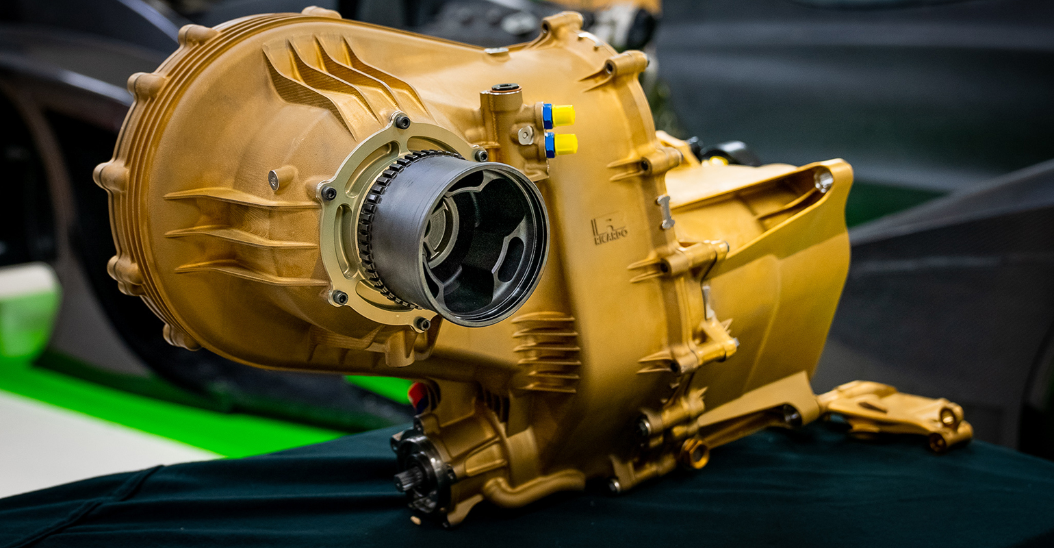

“With the Rodin FZero gearbox, we had specific criteria we wanted to meet in terms of weight and durability,” Dicker explained. “Because of the size and quality required for such a large component, it was only possible to print it on 3D Systems’ DMP Factory 500 machine. We couldn’t source another AM supplier who was able to offer a similar solution for our needs - the print quality, volume capacity, testing facilities in Leuven, and continued technological support.”
Rodin Cars engineers worked with 3D Systems’ Application Innovation Group (AIG) to produce the custom-design gearbox, which has 2-mm-thick walls and weighs only 68 kg. 3D Systems AIG application engineers in Littleton, CO, optimized the gearbox print design for additive manufacturing at the large scale achievable on 3D Systems’ DMP Factory 500 printer, and the first part was produced at the AIG location in Leuven, Belgium.
The customized gearbox for the new Rodin FZero resulted from an 18-month design process by Rodin Cars and Ricardo, a British engineering firm. They developed a Grade 23 titanium casting to house a hydraulically controlled differential. Metal additive manufacturing was the only way to achieve the internal galleries and thin-wall bearing and mount structures, according to 3D Systems report.

Rodin Cars, a New Zealand-based manufacturer of high-performance racing cars, chose 3D Systems’ metal additive manufacturing technology to produce tooling and final parts for its soon-to-be-released “hyper car,” the Rodin FZero. Among hundreds of metal parts for the new model, Rodin Cars is using 3D printing technologies to manufacture a customized, eight-speed sequential gearbox with a hydraulic differential.
