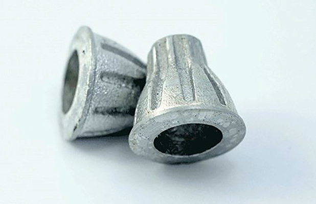

An extraordinary announcement at the end of November – just weeks ago as I write – suggests the end for all of us who work in or adjacent to metalcasting, due to a breakthrough technology. A New Zealand start-up called Foundry Lab raised $8 million in its first pitch for outside investors, explaining it has developed a “digital microwave casting” technology that produces “cast” metal parts with same-day turnaround. Further, this venture claims its Digital Metal Casting (DMC) technology is able to compete for business in high-volume manufacturing applications that are unachievable with current metal additive technologies, thus combining the cost-advantages of foundry or diecasting production with the speed of 3D printing.
The developers have identified every shortcoming of metalcasting, and propose their new technology to address those, to make foundries and diecasters obsolescent.
Foundry Lab also claims to offer design advantages over CNC machining, with the flexibility to create metal parts in any casting alloy, suitable for functional testing before production begins.
I’m not so bold as to call this news unbelievable, but on the evidence provided it is implausible. I’ll remain skeptical until more details are revealed: How is raw material reformatted as a final shape? How do the parts perform? I’ll trust the investors to understand what they’re buying, but I’ll expect metalcasters and casting buyers to evaluate the process and its results too.
After all, those making this announcement are indicating that sand and binders, furnaces and refractories, molds and cores, shakeout systems, etc., are no longer required to produce ‘castings.’ The people who know those process technologies best understand that none are ideal; there are costs and risks, and shortcomings to metalcasting as it is. The same is true for metal 3D printing and CNC machining.
