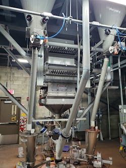

MBHEs that use vertical plate technology are derived from traditional plate heat exchangers (PHEs), which are still commonplace in numerous process industries. While PHEs allow heat transfer from one fluid (liquid or gas) to another fluid, MBHEs that use vertical plate technology allow indirect heat transfer between solids and fluids.
In an MBHE, the material enters the unit and flows by gravity through banks of parallel vertical stainless-steel plates. A heat transfer fluid – typically water – passes through the plates to heat or cool the material by conduction.
A discharge feeder in place at the exit of the MBHE controls the rate of flow through the heat exchanger while providing uniform mass drawdown. Thermal modeling calculations using material property data ensures precise discharge temperature control.
This passive, indirect form of heat transfer – the flow velocity typically is less than 0.3 m/min — means MBHEs do not contribute to any additional dust formation or degradation of sand quality. By reducing the generation of dust and mitigating the chance of dust egress, moving bed heat exchangers also lessen the loads on existing baghouses and dust collectors.
In contrast, direct-contact methods such as fluidized beds rely on ambient air drawn into the system using high-horsepower fans. The air is blown through the sand – and while this provides an effective way to condition the sand, it is a highly agitating process that leads to abrasion, attrition, and the formation of large quantities of dust.
Fluidized beds also require blowers, ducting, and associated air-handling and -cleaning equipment to circulate the air and then clean it before it can be discharged to the environment. MBHEs do not use air, meaning plant operators can realize significant savings in energy requirements along with a reduced potential to generate dust while cooling the sand.

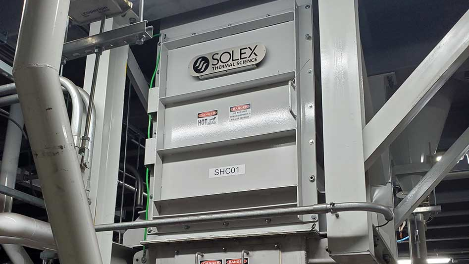

In 2022, Solex Thermal Science worked with Benton Foundry as it began an expansion program aimed at to doubling its coremaking capacity from 5,000 to 10,000 tons of cores annually.
The northeastern Pennsylvania gray and ductile iron foundry, which has been in continuous operation since the mid-1800s, was using a fluidized bed to condition the sand it uses to manufacture cores for valves, flanges, pipe fittings and auto, truck and tractor parts.
The cast house required an updated air-quality control capability that would match the increased throughput while also offering tighter process controls.
Benton selected Solex to develop a customized, pillow-plate MBHE that is rated for an average of 8,000 lbs/hr up to a maximum of 14,000 lbs/hr. With accurate sand discharge temperatures guaranteed, the new MBHE also minimizes energy consumption.
Commissioned in mid-2022, the Solex solution has proven to be a “unit of choice,” according to Tim Brown, vice president at Benton Foundry.
Brown noted that the MBHE creates near-zero shear forces when conditioning the sand and that, due to its gentle handling of the sand, does not fracture or breakdown the grains. This has made it a good fit with several recent significant dust-control and energy-management initiatives that earned Benton Foundry the American Foundry Society’s 2022 Green Foundry Sustainability & Stakeholder Engagement Award. For example, the foundry also installed new robotic grinders and cleaning machines to automate the finishing process for castings, while also mitigating additional dust exposure to foundry workers.
More points in favor
Brown noted that the new MBHE also helped Benton realize some valuable energy savings. Because the system does not require high-horsepower air-handling and -cleaning equipment, he estimated energy consumption is nearly half the requirements of the previous unit, with savings projected at around 100,000 kWh annually.
“It is definitely saving us money through reduced energy consumption, but also fewer repairs and less maintenance because it has fewer moving parts,” Brown said.
