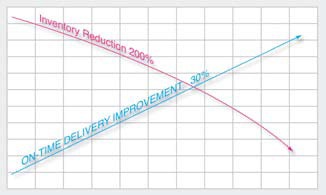

Kurt Die Casting’s Lean manufacturing initiatives have improved delivery tims and reduced inventory costs — savings that have been passed on to customers, the Minneapolis producer of aluminum components explains. ...
Minneapolis-based Kurt Manufacturing Co.’s Die Cast plant reports that its Lean initiatives have resulted in significant operating cost savings — over $1.2 million thus far — which it says have been passed on to customers. “The Lean program includes newly automated processes, concurrent engineering with our customers, and adding new die casting equipment,” according to Kurt Die Casting division manager Bernard Soya. “We have improved quality and time-to-market while reducing product costs.”

“Within our Lean initiatives, we utilized a Kanban (JIT) production system which provides a faster, easier, and more costeffective way to complete the production process,” according to Soya. “We implemented a workcell flow process for a leading agricultural manufacturer, resulting in a 30% cost reduction on that diecasting project.”
Soya also reports significant inventory reductions through Kurt’s Lean program. “We have been using internal Kanbans to control the work as it goes to the floor for secondary operations,” Soya reported. “The system is very visual, allowing all departments to manage inventory and to see what needs to be produced. This has resulted in a 50% reduction in set-up time on many jobs while increasing inventory turns up to 200%.”
