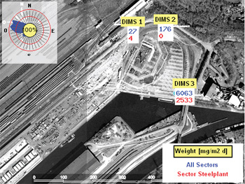

Three measuring stations situated on the plant site recorded heavy dust emissions with westerly winds (green arrows) during the hours indicated on the top graph. The wind speed is plotted in the lower graph.
