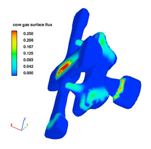

Binder loss in two internal cores of a valve iron casting
Spatial plot of core-gas pressure at 5 sec. A two internal core assembly was bottom filled in the simulation in 1.5 sec. The gas pressure in the saddle core is roughly double what it is in the T-core. The vertical drill in the T-core along with one T-core print is very effective in venting all the T-core binder gas. The saddle remains inadequately vented in this design.
Filling of an open flask partial V8 aluminum block assembly. The two cores form the water jacket cavity of the block. The flask is bottom filled in 20 seconds …
… and the water jacket core when unvented blows gas into the metal during fill (Fig. 3b).
