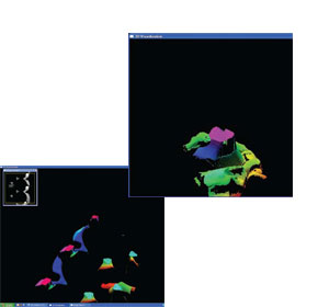

Continuous 3D surface maps of the core’s exterior depict height variations in color. The maps are created by coordinating data assembled from three-dimensional images of the core, captured as the robotic handlng device transports it from the coremaking machine to the molding line.

The camera builds a 3D surface map by combining “profiles,” individual images that reveal the position of the laser line. The camera collects up to 5,000 profiles per second, processing them in real time on the FPGA and microprocessor, and compositing them into a continuous 3D surface map of the core’s surface. On the map, height is displayed as intensity — in the case of grayscale display — or as color, in the case of false-color surface map display.
Two sections of the surface map show the elevated tabs (highlighted in green) that rise above the surface of the core; areas where the tabs are missing will fill with molten aluminum, forming defects in the casting.

Although the combination of optics, camera field of view, and size of the core, established a minimum spatial resolution of 0.2 mm for inspecting the breather tabs, Nemak ‘tweaked’ the threshold to catch larger defects in the tab structure, which improved the system’s throughput.

In tests, the Vista Solutions/Sick system showed a total effectiveness of 98.17% on 10 parts: six were good parts, four had known faults. None of the errors allowed failed parts to pass. Similar grayscale systems generated 85% effectiveness, and passed parts that were known to be defective.
“During our trials with the 3D system, the false trials were attributed to multiple handling of the parts that caused them to fail on their third trial,” explains says Nemak’s lean manufacturing coordinator, Mandy Karnib. “In short, the 3D laser system has been extremely beneficial in allowing us to significantly reduce our breather-core scrap, both internally and externally.”
