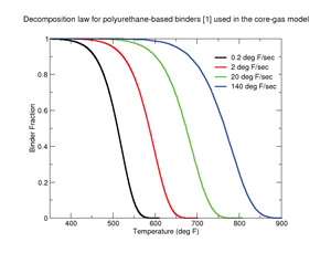

Figure 1: Experimentally derived pyrolysis decomposition law for polyurethane resin used in the core-gas model. The binder loss occurs at lower temperatures for lower heating rates. The blue curve corresponds to conditions typical at the sand core surface.

The breakdown of the sand binders begins at the core surface, which heats into the binder decomposition range shortly after immersion into metal. The existing data indicates that the decomposition range of polyurethane based binders is roughly between 440° and 800°F (see Fig.1). The computational model assumes the worst case scenario of complete binder mass conversion into gas and the gas is taken to have a fixed composition. The gas generated in the core flows towards the vents with the associated pressure loss. Since the vents typically remain at much lower temperatures than the regions where the binder is gasifying, significant thermal contraction of the binder gas during flow is expected and the product gas is treated as compressible. Furthermore, since the main volatile species (carbon monoxide, carbon dioxide, hydrogen, methane) flow at temperatures and pressures well above the component condensation points, the product gas is treated as ideal. Water vapor is clearly an exception and is not considered in the model.
