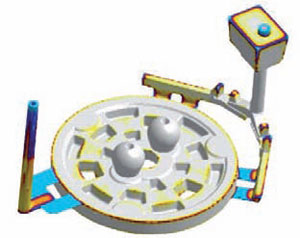

Solidification simulation of a gear wheel cast at the Amstetten foundry, created using Magmasoft simulation software. Optimizing riser placement saved an estimated $57,600 in the production of this part.

The Engineering department uses Magmasoft® casting simulation software to link its computer-aided product design efforts to the metalcasting operation. In effect, casting process simulation allows designers to see inside the mold to understand and predict precisely what will happen during pouring and solidification. As a result, metalcasting engineers can accurately characterize the casting process and predict the finished casting’s properties before production begins.

Amstetten uses simulation throughout product and process development, to conserve materials and save costs, and to drive innovation and optimize component integration. For example, developing a “riserless” casting reduced the production of return scrap. Since molten metal contracts as it cools, additional metal usually has to be introduced to the mold via risers in order to avoid defects and porosity. Those factors can be addressed during simulation to reduce return scrap and material consumption. Before investing in Magmasoft, Amstetten calculated simulation would reduce return scrap 8%, which would lower annual material costs by a six-digit figure. Additional cost savings accrue from optimization over the entire process. Thanks to the calculated cooling times, it is safe to run production at the fastest possible rate.
For instance, it was possible to reduce shrinkage cavities significantly while manufacturing a chain guide by reducing riser volumes and altering the gating system. This led to a significant quality improvement, as well as a manufacturing cost reduction estimated at $22.75 per part, primarily because they managedto reduce return scrap by approximately 2.5 kg. Given an annual production of approximately 300 pieces, this is an estimated savings of $6,768. Also thanks to solidification simulation, it was possible to reduce the number of risers from five to two during production of a gear wheel. Together with a 69-kg reduction in return scrap, this lowered manufacturing costs by an estimated $44.65 per part.
