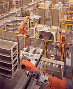

At the Nemak Windsor Aluminum Plant (WAP) in Ontario, core machines blow sand premixed with resin into tool cavities to create the individual core sections. Each core section is robotically assembled to form the complete core package, which then is ready for pouring.
The production lines use foundry-specific robots that are sealed from moisture and dust and are able to sustain consistently high temperatures. ABB Robotics (www.abb.com) has been working with Nemak on planning, support and strategies for robotic handling and assembly of sand packages since1998. It has set up the robotic lines for several Nemak facilities worldwide. Gustavo Sepulveda, ABB’s general manager for Robotics at Nemak Mexico notes that Nemak typically uses 6-axis robots with a 200-kg load capacity. “Each facility is different,” he says. “On average, every line has between 12 and 15 robots. Some of them may be handing extra parts, or they have added additional operations beside the sand core assembly. The minimum number is typically 12,” he says.
Fanuc Robotics America Inc. (www.fanucrobotics.com) provided the robotic lines for WAP. John Utley, Fanuc, project manager explains that a series of core machines, each making a piece of what will be assembled into the final core mold, form the front of the lines. Each core machine has a robot installed in front of it. When the machine produces the sand core, the robot moves it to a table where a sub-assembly process is performed on each core.
“We can load them directly onto the main line where the cores would proceed through all subsequent steps. Or, if the line is blocked upstream for any reason, we can have the robots pick the set of cores and load those to the shelving system on the other side of the line. There are six sub-system cells set up along a main line assembly line — start to finish,” Utley details. “The package gets built up until there is a complete core package at the end of the line.”
Utley notes that the line is set up with both pedestal- and rack-mounted robots. The pedestal mounted robots handle the core machine unloading operations while the rack mount give a more vertical envelope for the buffer shelf positions needed on the other side.

Stockwell says, “We rely on our systems to pick up cores and manipulate them, inspect them, and then assemble them into a package. There is very little tolerance for positioning. If the core is not gripped properly or not inserted properly into the package, it will break. It’s a delicate process. The way the fixtures are set, the precise repeatability in the way grippers hold the core, the way the robots verify that the core is in the correct position – all of those aspects are extremely important.”
Six sub-system cells in the assembly line complete core packages. (Photo by courtesy of Nemak.)
From the robotic point of view, holding the part with the right type of gripper is only one aspect of performance. Utley notes that from the perspective of a robotic assembly process, it is also a challenge to fit the cores together precisely without any rubbing.
“If you don’t do that, you are going to abrade sand that will fall down into areas of the core and compromise the pouring process, resulting in defects in the casting,” he says. “The tooling and everything involved with the robot system must be precise and support the cores in ways that show no variation whatsoever.”
