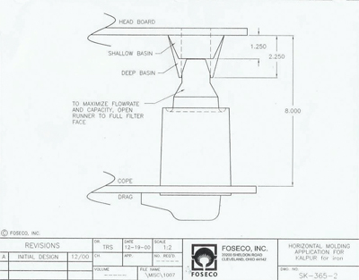

Fig. 1. A diagrammatic sketch of a typical horizontal molding application.

The KALPUR direct pouring unit consists of an accurately formed core-shot reverse-tapered insulating sleeve with a correctly proportioned SEDEX® filter fixed in place. This sleeve/filter combination takes the place of a conventional side feeder on automatic horizontal molding machines, and completely replaces the need for a conventional runner system. In other words, the KALPUR direct pouring unit is comprised of all the necessary components — feeder, pouring cup, and filtration system — for the production casting or castings in question.
. 2. The cope-side pattern plate, showing the Kalpur riser bob with a sprue extension.
With respect to the insulating sleeve, “reverse taper” means that the KALPUR direct pouring unit can be placed on a suitable “print” on the joint-line and simply “closed over” like a core. The narrow end of the unit is always presented to the wide end of the cavity formed by the riser “bob” or pattern.

Due to the reverse taper design, when the unit is placed on the joint (drag-side) the cope half mold can close over without fear of crush. All the foundry operators need to do is attach a sprue extension to the riser bob, as shown in Figure 2. This extension mates with the pour cup, fixed to and formed by the squeeze headboard, and the mold is ready.

Note that the pour cup attached to the headboard has a suitable hole to accommodate the sprue extension and allows for operational differences in sand compaction, as shown in Figure 1. Using this system, foundries can improve their pouring yields by an average of 10% simply by eliminating the conventional running system.
