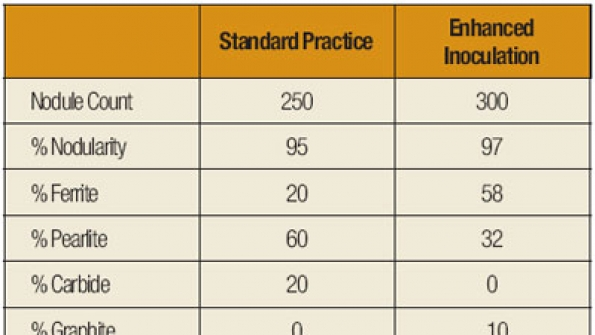

Foundry A is a medium-sized foundry making thin-section (0.25 inches or less), shell-molded castings. For years, carbides have been a serious problem. Attempts at switching inoculants and/or blending inoculants brought little to no improvement. The foundry’s customer = had to anneal all castings to eliminate carbides. To reduce costs, the customer indicated that the castings must be produced as-cast to avoid costly heat treatment and improve machinability.
Foundry A produces ductile iron to a 65-45-12 specification. Melting is done in a 6,000-lb. medium-frequency induction furnace. A 1,200-lb. tundish ladle is used for magnesium treatment; 1.75% GloMag R6-8 magnesium ferrosilicon is added to a 1,000-lb. tundish ladle, and topped with 7 lbs. of cover steel. The standard post-inoculation practice consisted of adding 4.5 lbs. of Calsifer 75, a calcium-bearing 75% ferrosilicon. A K15 cast insert is used in each shell mold. Numerous attempts at using inoculant blends failed to eliminate carbides. The most successful combination of inoculants was found to be 3.0 lbs. of Calsifer 75, 3.5 lbs. of VP216, and 0.6 lbs. of Sphere-o-Dox that was used an inoculant enhancer. The occurrence of carbides in thin sections was dramatically reduced or eliminated only when Sphere-o-Dox was used.
Table 1 compares the pertinent properties of the standard inoculant practice compared to using the modified practice that incorporates Sphere-o-Dox S as an inoculant enhancer.
The mechanical properties obtained from these same castings is shown in Table 2.
Both the microstructural and mechanical property improvements elicited very favorable results for the customer. In addition, elimination of the annealing cycle and improvement in machinability resulted in significant cost savings.
