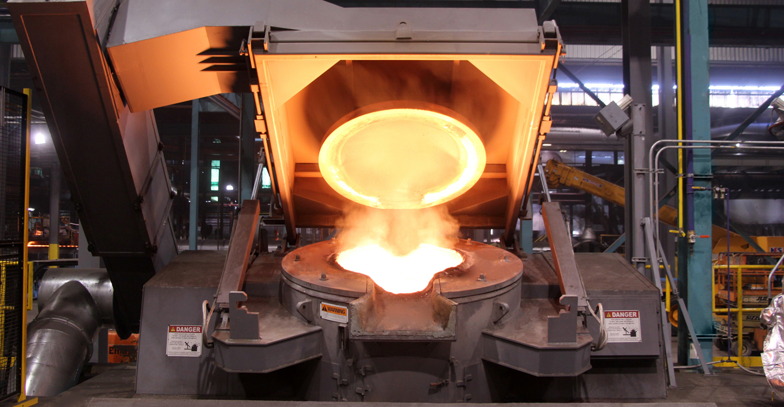

Coreless-Type — A coreless induction furnace operates at low, intermediate and high frequencies — from 60 to 10,000 cycles/second — and is unmatched for flexibility. It also operates by transformer action, but in this case it is similar to an air-core transformer. The primary coil induces current directly in the metal charge, which is contained in an unobstructed crucible or refractory lining. There is no internal melting loop or channel. The primary winding is a water-cooled copper coil surrounding the outside of the crucible or refractory lining.
The coreless furnace can be started cold and usually is poured empty. This greatly simplifies alloy changes and makes it possible to shut down as desired.
Linings of coreless furnaces may be as durable as core-type furnace linings in applications where a molten charge is maintained 24 hours a day. Because of alloy changes or analysis control, however, batch melting is the usual practice and the recurring heating and cooling results in less lining life. On the other hand, these linings are considerably less expensive and can be changed quickly.
Because there is no flux-concentrating core as on core-type furnaces, the efficiency of the coreless furnace usually is lower than that of core-type furnaces. Normal efficiency is approximately 75%. Smaller coreless furnaces are designed to operate at higher frequencies in order to maintain good efficiency and proper stirring action.
Frequency vs. Size — There is always an ideal relation between the size of a coreless furnace and its operating frequency. As a rule, a small furnace will yield the best results at high frequencies and a large furnace works best at the lower frequencies. There are optimal frequency ranges that are best suited to certain furnaces that produce good, fast melting with a gentle stirring action. Too high or too low frequencies are accompanied by undesirable side effects.
When a furnace is operated at a frequency lower than ideal the result may be a violent stirring action that may produce inclusions of slag and refractory particles, as well as gas pickup. Metal loss may be excessive due to excess surface area of the melt and oxidation of volatiles, making startup harder, and thus it may be necessary to charge with greater care. Additionally, some types of scrap cannot be used for starting.
In many cases the most important fact is that lining life can be reduced by using too low of a frequency. On the other hand, if too high a frequency is selected for the size of the furnace, there may be a complete lack of stirring, uneven heating throughout the charge, excessive side-wall temperatures and difficulty in attaining homogeneous melts.
