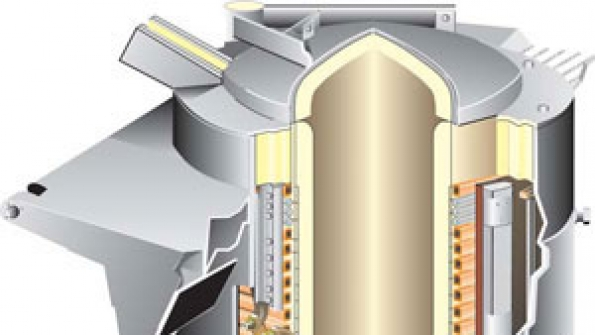

Do you want to maximize lining life and coil life in your induction furnace? Of course you do. Many people don’t realize both factors are interrelated.
Melt shops can become complacent with maintenance of their lining procedures as well as routine maintenance of their melting equipment as the shine on their new equipment fades. Short lining life and coil life result in increased downtime, costs, and frequent coil changes.
This article explains the reasons for short lining life and short coil life and their effects on the melt shop, and outlines methods to save thousands of dollars in repairs and lining costs per ton of melted metal.
We will focus on a coreless furnace application melting ferrous materials using silica refractory as the working lining. Thoughts expressed in this article pertaining to ferrous materials are similar to those expressed for nonferrous materials, using an aluminabased refractory.
Over the years, melt shops have reported coil life as short as one year or less while others report coils lasting three to five years and even longer. Generally speaking, melt shops reporting longer coil life cycles experience good lining life campaigns as well.
Let’s review reasons for a shorter lining life span and, in turn, its effect on the coil life.

Preventive maintenance
Many melt shops have periodic preventive maintenance procedures in place while others do not. The furnace manufacturer should be contacted to obtain the recommended preventive maintenance schedule and procedure for the power supply, furnace and associated equipment in the melt department.
If the furnace assembly is not properly maintained, short coil life will result. If magnetic shunts are used in the furnace design, they need to be torqued periodically to ensure they stay in the proper location supporting the coil. The torque procedure should be in accordance with the furnace manufacturer’s recommendations. Loose shunts can move during operation and come in contact with water connection pipes and hose barbs causing arcing and coil grounding.
Power lead and hose connections need to be checked for leaks during the preventive maintenance procedure. Water leaks can cause coil arcing, resulting in short coil life. In addition to power leads and hoses, other furnace components such as top cast blocks, Faraday rings, tie rods, furnace covers and cylinders should be checked during the preventive maintenance procedure.
