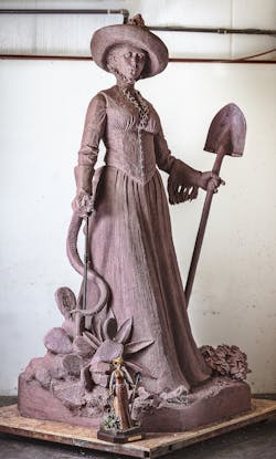

Bronzesmith’s special rendering capabilities draw on the expertise of its in-house art staff together with its 3D digital-scanning technology. This allows the foundry to model almost any work accurately as a foam reproduction. Also, the foundry is able to scale up or scale down virtually any piece to achieve the desired size, up to 20 ft tall.
“I thought Bob’s pioneer woman image would be an excellent subject to render as a monumental sculpture,” Reilly reported. The finished work, titled “Not-So-Gentle Tamer”, will be installed at Arizona’s Prescott Valley Civic Center.
“So, with the painter’s close collaboration and the support of our local government officials, Bronzesmith artist Debbie Gessner began the task of re-creating the image in clay. This was a major undertaking as the final work would stand 10 ft tall.”

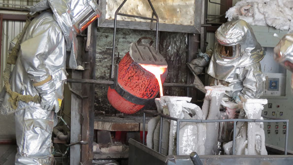

“We melt in a gas-fired removable crucible furnace equipped with No. 150 Morgan Molten Metal Systems silicon-carbide crucible,” Reilly said.  “We begin with a charge of 500 lb of high-quality bronze ingot made up of 94% bronze, 4% silicon and 2% other metals. During melting, we use a light surface application of boron, and slag the furnace frequently to ensure we are maximizing metal cleanliness.”
He added that the crucible’s exceptionally hard and dense, non-wetting interior surface helps maintain metal purity by reducing metal penetration and resisting slag build-up.
Wearing full protective gear, metalcasters remove a MorganMMS Indux crucible filled with molten bronze from a gas-fired push-out furnace.
“After the metal is fully molten and at the desired temperature, we use an overhead shank system to lift the crucible from the furnace for pouring,” Reilly said. “This makes it particularly important that the crucible be strong and highly reliable.
“With our current crucible, we are able achieve 100 heats before replacing it, a far better service life than the crucibles we used previously,” he reported.
“We pour in air into ceramic investment casting shells mounted on a stainless steel frame,” Reilly continued. “These ceramic shells have been heated to 1,250°F (676°C) in our gas-fired kiln. Our pouring temperature is 2,150°F (1176°C) and it normally takes about six-and-a-half minutes to complete the entire pour. Our largest shell holds 150 lb (63 kg).
Large-scale works — like “Not-So-Gentle Tamer” — are cast in sections, cleaned and machined, and welded together to make the final sculpture,” Reilly said. “Smaller sculptures, such as miniatures of our piece, are cast as a single unit.”
