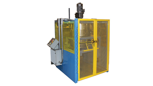

The Dross Boss™ recovery process starts with the transfer of a mixture of hot dross and recoverable aluminum from a melting furnace to a special “reaction vessel” (RV.) Then, that load of material is transported by lift truck to the mixing station, where it is manually loaded on an elevator before starting the recovery operation.
Depending upon the dross condition and the presence of flux from prior treatments, a small additional quantity of exothermic flux may be added to support the gravity separation of aluminum metallics from the hot dross.
A view of the reaction vessel cart being loaded into the mixing station for the recovery operation.
The recovery operation is controlled by a PLC program that raises the RV to engage the mixing blade in the dross mass, starts the rotation of the gear motor and mixing blade, and runs an optimized program to achieve a gravity separation of the entrapped alloy and oxides.  The recovered metal drops to the bottom of the RV while the oxides float on top. The actual process time in the mixing station is less than five minutes. Then, the end product is drained from the reaction vessel through a bottom port.
