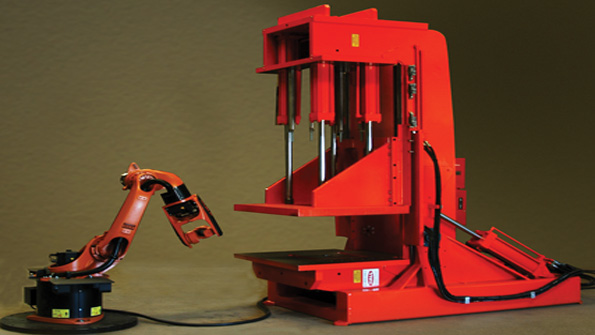

Conventional tilt-pour casting machines have frames or tie bars that can hinder robot interaction with the machine.   Machinery designers have long felt that the die should be clamped in a “box” making tie bars necessary in a C-frame style machine.  CMH Manufacturing believed there had to be a better way and began to design a series of tilt-pour casting machines that do not use tie bars.  The development started with the Hall 3HS, the most popular tilt-pour casting machine in the domestic foundry market, resulting in the 3R.  The 3R is the same size as the 3HS but has no tie bars to hinder the robot interaction.  Possible robot functions in the cell include: Core placement in semi-permanent mold casting; ladling; casting extraction; post-extraction processing; and inspection.

Based on the knowledge gleaned from testing the 3HS we were able to eliminate the tie bars by converting the flat-sided C-frame to an I-beam at the front.  We converted the rear of the machine and the ram cylinder mount into a reinforced box.  Corner stiffeners were added in eight places.  The movable platen was converted from two inches thick to three inches thick.  In order to give more balanced clamping force we converted from the two 5-in. ram cylinders (39.28 sq. in. cross sectional area) to four 4-in. ram cylinders (50.28 sq. in. cross sectional area.)  The increased clamping force means that the pump pressure can be reduced, improving pump life.  Another design improvement was to adopt high-performance linear ball bearing way bars.  Using exactly the same testing procedure described above we scanned the 3R machine, with the following results (deflection in inches):
As shown, the front platen on the 3HS deflected 0.058 in. compared to 0.0315 in. on the 3R, a 47% improvement.  The 3HS rear platen deflected 0.048 in. compared to 0.0395 in. on the 3R, an 18% improvement.  The 3HS movable platen deflected 0.017 in. while the 3R deflected 0.001 in., a 94% improvement.
With the success of the 3R, CMH quickly developed the 6R, which can operate dies 60x60 in. and weighs 13,000 lb.  The addition of the 6R gives CMH Manufacturing the ability to offer permanent mold foundries three sizes of machines without tie bars.
