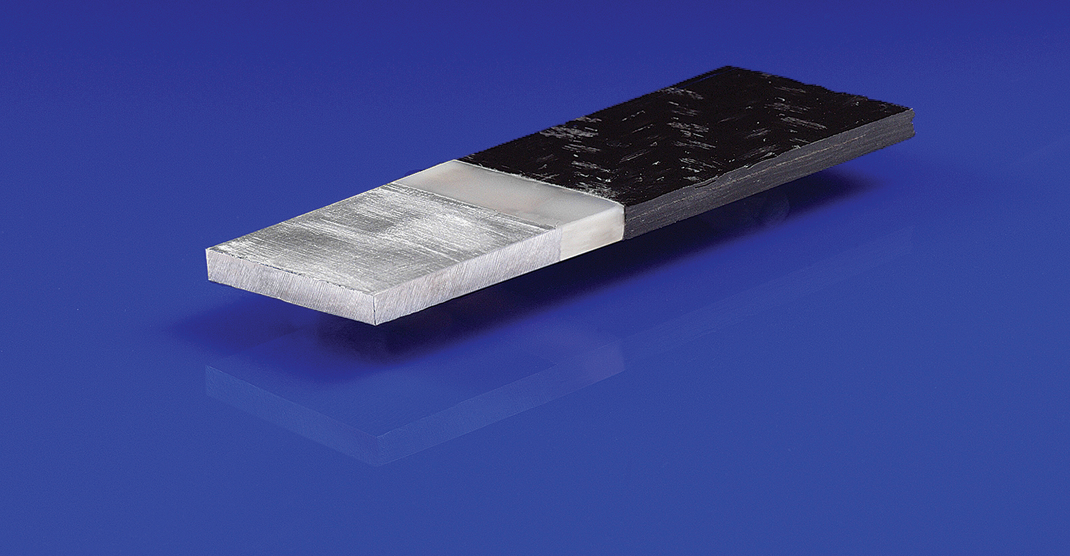

In the high-tech world, in commodity-grade consumer products, and in between across the vast span landscape of design engineering, “lightweight” is the defining principle. It follows that products and systems designed to achieve low-mass or lightweight objectives frequently incorporate specialty alloys or composite materials. “Hybrid” structures that combine fiber composite materials and/or wiring with lightweight metal alloys are a recent devlopment, and may be especially effective for automotive and aerospace parts. The current “state of the art” involves bonding or bolting together the metallic and composite elements of these designs.
Over the past several years Germany’s Fraunhofer Institutes for Manufacturing Technology and Advanced Materials (IFAM) have been developing joining methods for various types of hybrid joints involving high-pressure diecastings. In contrast to bonding or bolting/riveting components together, casting designs of customized composition results in parts that are comparatively more compact, lighter, and exhibit better galvanic isolation (i.e., any electrical circuits incorporated in the structure are separated to eliminate stray currents; signals may pass between galvanically isolated circuits, but stray currents, such as differences in ground potential or currents induced by AC power, are blocked.)

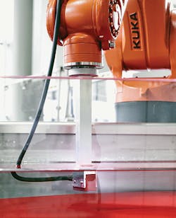

In addition to X-ray methods, the project is pursuing thermographic, acoustic, and magnetic inspection by the Fraunhofer Institute for Non-Destructive Testing (IZFP.) “Active thermography” achieves rapid, easily automated defect detection, such as crack detection and identification of delamination and fiber fractures in carbon-fiber-reinforced plastic components.
Depending on the component, excitation occurs using optical impulses, ultrasound, or induction. With a resolution of about 15 mK, and an image frequency of 20 kHz, it can detect small variations in thermal flow, which may be caused by defects.
Ultrasound testing is another NDT method. Depending on the requirements, tests using electromagnetic ultrasound (EMAT), airborne ultrasound, or high-frequency ultrasound in water immersion are options. Multi-frequency eddy-current testing is another possibility. By exciting frequencies in the range of 100 Hz to 10 MHz, microstructural differences in metal can be detected, along with layer separation and cracks.
