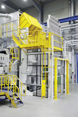

KS Huayu AluTech is an aluminum automotive foundry in Neckarsulm, Germany, that addressed the “large charge” material problem with a new melting furnace: StrikoWestofen’s “BigStruc” model. Not only can this gas-powered furnace handle return material up to 2.5 meters square, it can melt the aluminum scrap energy-efficiently, even at low bulk densities.
StrikoWestofen developed the BigStruc furnace to handle large stacks of pig iron just as well small, thin-walled return material. “After loading, the shaft of the furnace is closed with a cover called a ‘hot gas baffle’,” according to Peter Reuther, senior vice president for the equipment developer. “It keeps the heat in the shaft, preventing energy from escaping unused.
“It also keeps the melting process efficient even at high-void volumes,” Reuther emphasized.
After charging, the BigStruc shaft is closed
with a hot gas baffle that keeps heat in the
shaft and reduthermal energy loss.

KS Huayu AluTech selected the BigStruc with an enlarged shaft geometry, a capacity of 9 cubic meters for staging aluminum charge material. This means that large-dimension returns can be melted without the need for an operator or machinery to cut the aluminum into two or more pieces before charging.
In order to load BigStruc at the optimal time during melting sequences and keep the furnace well filled at all times, fill levels are monitored constantly via a laser-tracking system. This system functions even if the shaft cover is closed, according to the developer. Data collected on filling cycles, energy requirements, etc. can be archived and evaluated easily. Data analysis of this information can be used then for continuous improvement efforts, to measure and optimize melting efficiency and productivity.
