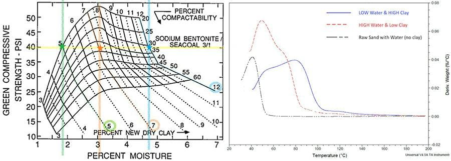

In 1989, R. Heine published a valuable chart on green sand (Figure 1) that illustrates the relationships between multiple sand parameters and Green Compression Strength (GCS). To achieve a 40 GCS (yellow line), the required moisture levels vary based on the amount of clay added, with more clay necessitating more water.
Examining three clay percentages – 5% (green), 7% (orange), and 12% (blue) – it is evident that the relationship between moisture and a 40 GCS is not linear. At 5% clay, approximately 1.8% moisture is needed, while 7% and 12% clay require around 3% moisture and over 4.5% moisture, respectively.
An alternative study involves plotting compactability against green compression strength, determining moisture levels for optimal green strengths by continuing to add water. Although additional moisture can enhance green strength, there is a point where further moisture diminishes its effect and lowers green strength.

Recently, a foundry supplier tested sand mixes on a thermogravimetric analysis (TGA.) Samples are placed in a crucible and subjected to a controlled temperature increase, and the mass of the sample is continuously monitored. This study evaluated the rate at which the water evaporated (assuming all mass loss was due to water evaporating). Narrow peaks indicate the weight is changing quickly. In theory the free water will evaporate faster/sooner, as there is no clay “holding” the water.
Samples included sand and water (no clay), sand mixed with high water and low clay, and sand mixed with low water and high clay. Theoretically, the sample with no clay would be 100% free water, as there is no clay to “hold” temper water. Sand with high clay and low water would have more temper water than free water, as most of the water would be held in the clay platelets. Low clay and high water would create an environment for free water, as there are not enough clay platelets to hold all the water.
Results and analysis
Figure 2 shows that the graphs aligned with expectations. The sample with only sand and water displayed a single, immediate “hump”, indicating that all the water was “free” and easily released. The high-water, low-clay sample (depicted by the red dotted line) exhibited an initial, substantial peak followed by a smaller one, suggesting the initial release of free water and subsequent release of temper water from the clay platelets. In contrast, the low-water, high-clay sample showed a delayed and higher peak, indicating a slower release of water.
Although the graphs confirmed predictions, quantifying the ratio of "free" to "temper" water remains a challenge, and using TGA equipment regularly on green sand samples is currently not feasible. It was also difficult to ensure a homogenous sample at the small size required by the TGA.
