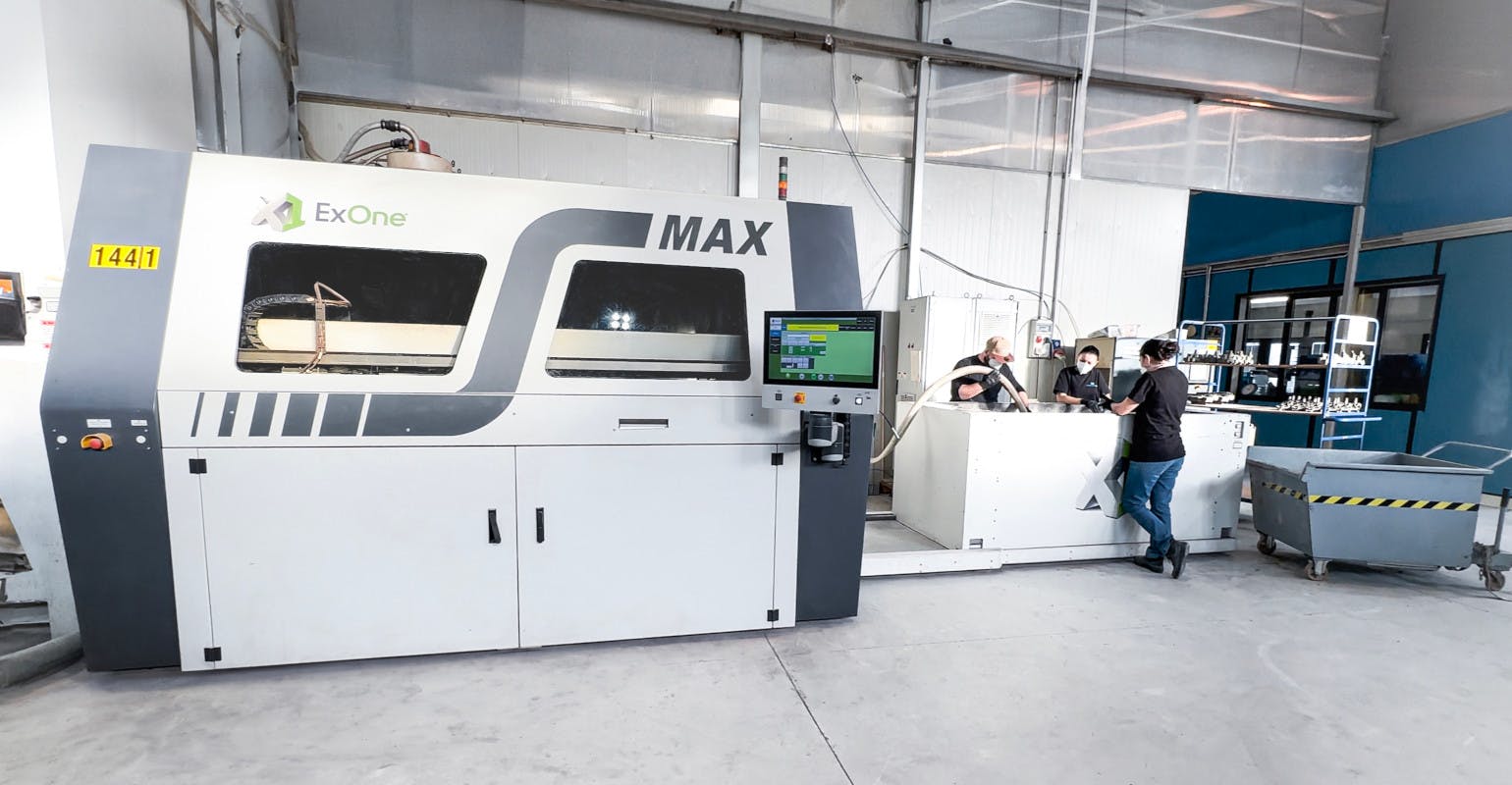

Corsa3D uses binder-jet technology to 3D-print sand cores and molds. The Milan-area business is a unit of Slayer Blades s.r.l., which is an ExOne Co. technology partner. It has a patented post-printing technique called Resin Soak that it claims improves the mechanical properties of molded parts, with applications beyond casting, including carbon lamination, furniture design, building restoration, and artistic applications.
