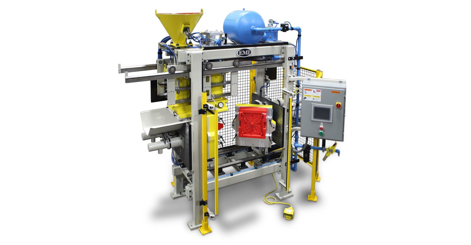

Integrated recipe functionality
One highly effective way to reduce core defects across different core products and machines is to use programmable logic controllers (PLCs) with recipe functionality. This feature is relatively easy to implement in modern core machines equipped with PLCs and human-machine interfaces (HMIs) for operational control. However, many foundries rely on older, relay-based core machines, so this will be a more costly upgrade.
Nearly any core machine equipped with PLC and HMI controls can integrate recipe functionality into the core room process. Each core product or SKU has unique process attributes, including sand and resin volumes, blow pressures, gas pressures, times, temperatures, and cycle counts. By carefully recording these settings in a recipe matrix, a skilled engineer can preload them into the HMI.
With this set-up, the HMI and PLC automatically control the core machine, removing the need for manual adjustments by the operator. Once the matrix is established and validated, the operator simply inputs the SKU information into the HMI, and the machine autonomously manages the process.
By leveraging accurately recorded process data and modern instrumentation and control technology, core room operators can produce higher-quality cores with a reduced likelihood of defects. This results in improved overall quality, less scrap, and increased profitability.
