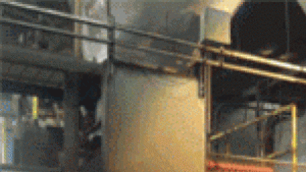

Frazier & Frazier has three furnaces melting various iron chemistries. Currently, it indicated that approximately 70% of its volume is ductile iron and 30% is gray iron.
