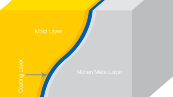

ASK Chemicals produces chemicals for all types of applications and uses in metalcasting, including mold coatings for sand and permanent molds.  These coatings act as a barrier between the mold material and the liquid metal.  One area of continuing process development is the coating process. What is the best way for the coating formulations be applied?
