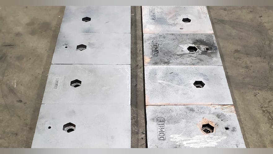

Previously, castings produced on the foundry’s no-bake line required manual cleaning and grinding, and the results still exhibited a rough surface quality.  Castings produced by the V-Process are more dimensionally accurate, according to Domite Wear Technology, requiring less grinding, and have a very smooth surface. “We have been able to lower the previously intensive labor and finishing costs by 75%,” according to foundry president Andrew Guiducci, “and the end product is a beautiful casting.”
Since last fall, when Sinto America completed installing the V-Process equipment, Domite has been operating the line at its full capability, producing about 10,000 lbs. of wear plates during March 2020.
