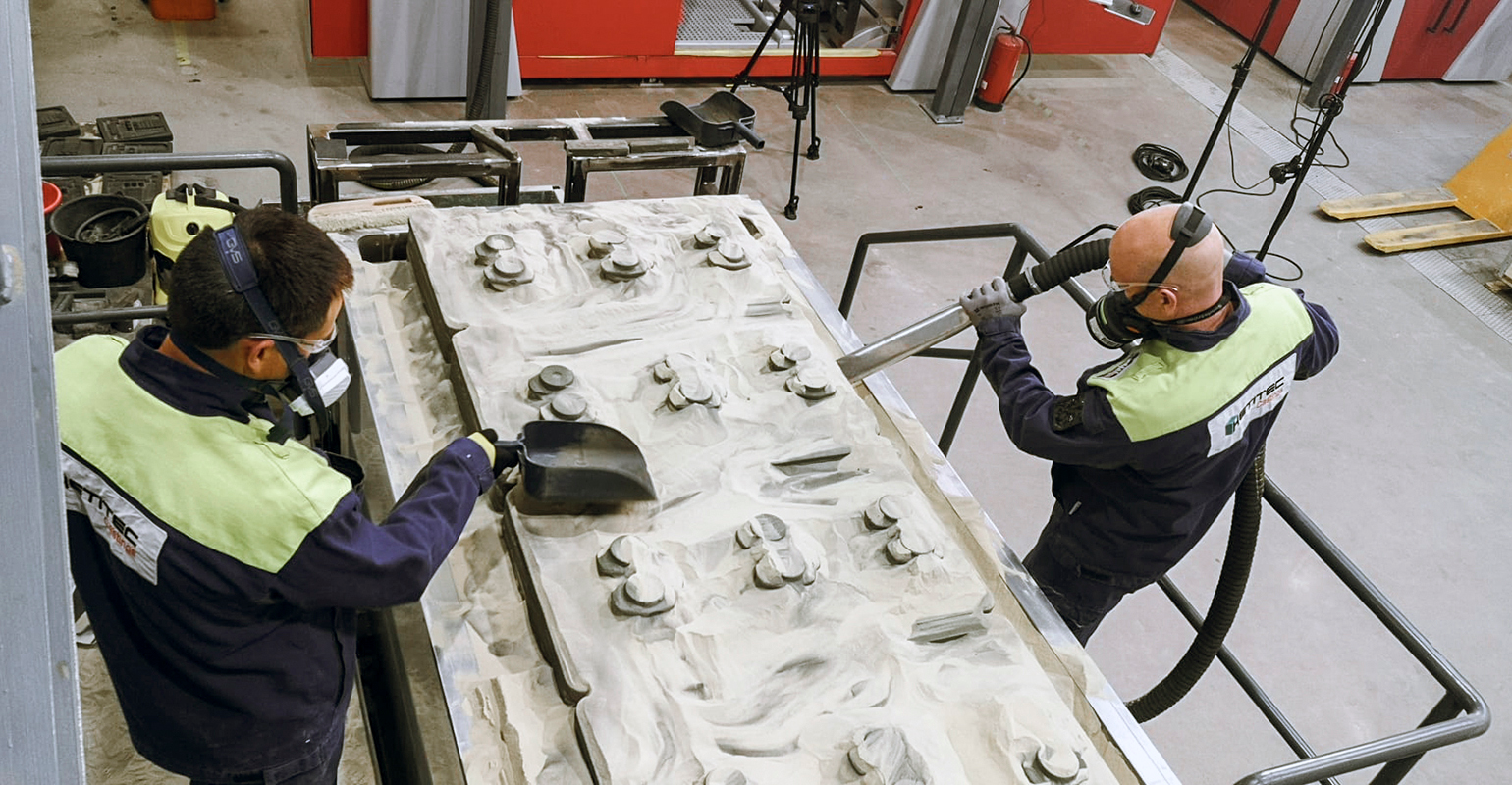

That’s where two ExOne 3D sand printers have been installed to produce cores for casting iron components, and that has initiated a new approach to foundry operations. The first printer, an ExOne S-Max model, was installed in 2018, followed by an ExOne S-Max Pro unit in 2021.
“I think we were looking for replacement technology,” recalled Tyler Hill, “something that gave us more flexibility to eliminate the need for assembling multiple cores… and something that allowed us to do more with casting designs.”
At the time of the installation Hill was the Iron Mountain foundry’s plant manager, though now his responsibilities have expanded as Grede’s group vice president, Commercial/Industrial. He oversees activities supporting customers in Class-8 truck, agricultural and construction equipment markets at five Grede foundries.
The initial S-Max unit is capable of printing furan or CHP bonded sands, with a large build platform (1,800×1,000×700 mm; 70.9×39.4×27.6 in.) that supports high volume, series production – but is also effective for prototyping. It has a build volume 1,260 liters (44 ft³), and a maximum build rate of 125 l/hr.
The second machine, the S-Max Pro, has a comparable build platform and build volume, but its build rate is 145 l/hr.
While the Iron Mountain foundry continues to operate some standard core-shooting machines, the 3D printers have introduced new possibilities for speed, precision, and simplicity in overall production. “By nature, 3D printing contributes to precise, higher quality components,” CEO Cary Wood stated. “We saw the potential for additive manufacturing to support greater repetition of complex core constructions and invested in new equipment to make it a reality at Grede.”
“It’s kind of a Swiss army knife,” Hill explained of the sand 3D-printer. “It does a lot for us. It does prototyping and some other things, but it also is a great production unit. And we run up to 220,000 pieces a year through that machine.”
