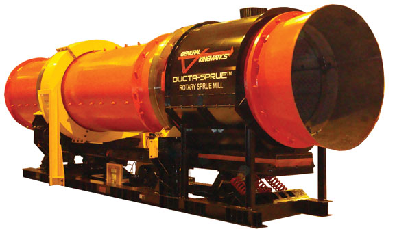

The foundry placed an order for a new DUCTA-SPRUE® rotary sprue mill, which incorporated a heavy-duty bolt-in drum liner system, as well as a vibratory sand-return conveyor. The combination provides patented rotary technology along with vibratory material transfer equipment that results in a long-lasting, easy-to-maintain system for processing sprue, gates, and core butts. The foundry finds that the combination of these two technologies fully addressed its previous maintenance concerns.

The foundry’s particular concerns also factored into the selection of its new rotary mill. The GK expert said the primary advantage of the Ducta-Drum is “the ease of customization and replacement for the liner sets.” Liners slide into the drum body easily, avoiding long periods of downtime.
The liner systems are fabricated from abrasion-resistant 450 Brinell steel. “This allows for quick construction of replacement parts,” Hutchens noted, “as well as customization of liner sets based on a foundry’s particular product type.”
This particular installation was effective and satisfactory for eight years, running the original liner set with only minor repairs until 2015. “The life expectancy for a liner set should be three to five years,” Hutchens offered, “depending upon usage and tonnage rates. We have seen customers extend the full liner set life by replacing partial liner sections in the high-wear zones.
