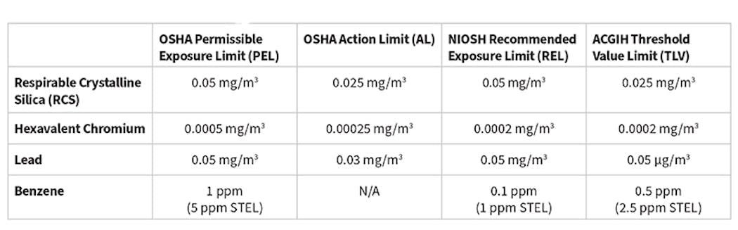

The U.S. Occupational Safety and Health Administration (OSHA) sets permissible exposure limits (PELs) for various substances that are commonly found in foundry emissions, such as total particulate matter, respirable crystalline silica, metal fumes, and gases such as carbon monoxide and sulfur dioxide. These PELs set limits on the amount of each substance that workers may be exposed to over a given time period. OSHA PELs have the force of law; employers that do not meet the PEL may face significant fines or legal action.
OSHA has set a PEL for total particulate of 15 mg/m3 as an eight-hour, time-weighted average, with a PEL of 5 mg/m3 as the respirable fraction.
For some highly toxic substances — including RCS, lead, cadmium, and hexavalent chromium — OSHA also sets a separate action level (AL), which usually is half the PEL. For substances with an AL, employers are required to have a written control plan in place if emissions are above the action level. They also may be required to take other actions, such as medical surveillance and worker education.
Foundry operators also should be aware of recommended exposure limits set by the National Institute for Occupational Safety and Health (NIOSH) and the American Council of Governmental Industrial Hygienists (ACGIH). These organizations set guidelines based on the best scientific evidence, which often are lower than the PEL set by OSHA. While these recommendations do not have the force of law, employers may want to aim for more stringent exposure limits to create a better working environment and to minimize health concerns.

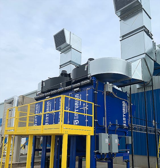

Engineering controls. Engineering controls are a core element of the dust-control plan. Engineering controls are measures that are designed to reduce or eliminate exposure to hazards in the workplace by modifying the environment or the equipment used. Examples of engineering controls for dust and fumes include:
  Using exhaust ventilation fans or ambient air-filtration systems to pull rising fumes from hot processes out of the building. Exhaust ventilation is typically accompanied by the use of makeup air systems to bring in fresh air and dilute contaminants to acceptable levels, to meet the PEL.
  Keeping dust- and fume-creating processes under hoods or enclosures with the use of a source-capture dust-collection system. A dust collector (such as a cartridge-style dust collector or baghouse) is used to filter contaminants out of the air.
  Operating vacuum systems for housekeeping activities, instead of sweeping with brooms or blowing down equipment with compressed air.
The EPA National Emissions Standards for Hazardous Air Pollutants (NESHAP) program sets limits on emissions for foundries, including particulates and hazardous pollutants such as benzene, formaldehyde, and hexavalent chromium. Engineering controls must be designed to meet both OSHA requirements for indoor air quality and EPA requirements for environmental emissions.
