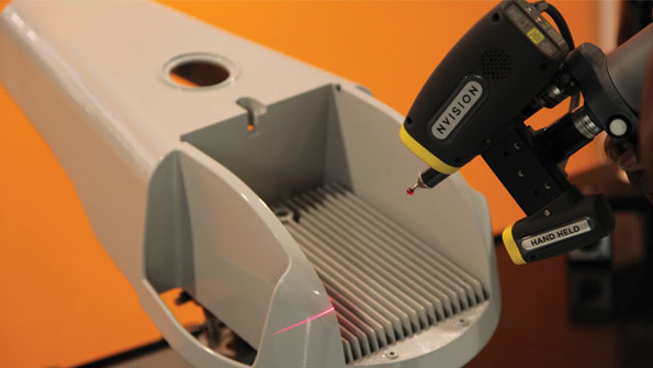

The producer has adopted a handheld laser scanner from NVision to ensure the dimensional integrity of the complex castings it purchases and uses to assemble its roadway LED fixtures. In the past, inspections were difficult because the castings’ geometry was too complex for gauges and blocks. Programming a CMM and conducting the inspections in that way was too time-consuming and demanding.
NVision Inc. develops high-accuracy, non-contact optical measurement systems and services for reverse engineering and inspection. The NVision HandHeld scanner is a portable device capable of capturing 3D geometry. The scanner is attached to a mechanical arm that moves about the object, freeing the user to capture data rapidly and with a high degree of resolution. An optional tripod provides complete portability in the field.

With the NVision handheld scanners, inspectors quickly capture the complete geometry of a complex part.
“It takes the operator about one hour to scan the casting and generate a point cloud that completely defines its geometry,” Williams said. Then it takes another hour or so to convert the point cloud to a surface model and compare it to the design intent.
Next, the inspectors use NVision software to compare the as-built part to the design intent. The software highlights in green areas of the part that are well within tolerance, in yellow the areas that are on the high side of tolerance, and in red any areas that are out of tolerance. The information alerts the manufacturer when the parts are edging “out of spec,” so corrections can be made — and scrap can be avoided.
