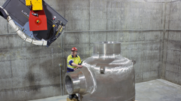

Bradken’s new concrete building has two radiographic inspection systems and 50-ton turntable to position large-dimension steel castings.

Initially Bradken turned to subcontractors to handle customers’ increased demand for radiography, but the rate of the increase in demand coupled with supplier constraints in lifting weight limits, size, and film processing quality, demanded a better solution. A proposal was put together to add additional radiographic capacity in the form of a second concrete bunker with a new, higher-powered 9-MeV linear accelerator that would expand Bradken’s radiographic capacity and capability. The project was approved in July 2011, and the design for the new vault and building was started.
To ensure the new construction would meet state and NRC requirements, Bradken hired a Washington State Department of Health-approved physicist to review and comment on the project engineering. The building design and materials went through several revisions before they were approved, and the final building included a vault with 8.0×40.0-ft-high walls and an 18-in.-thick concrete roof.
After construction was complete, two radiographic systems were installed: a 9-MeV linear accelerator supplied by Varian Medical Systems’ Security and Inspection Products, and a Cobalt 60 projector and source supplied by QSA Global.
AeroGo provided a 50-ton-capacity custom turntable for positioning and manipulating the steel castings during the inspection process, and a 50-ton crane was installed, too.
After commissioning the new equipment, a full environmental radiation survey of the building and surrounding area was performed to confirm that the approved shielding plan was indeed adequate. The survey was completed and the facility met all of the shielding requirements. Also, the survey was filed with the Washington State Dept. of Health, as a matter of record. The new radiographic facility, the second for Bradken at Tacoma, was approved for use in 2012.
