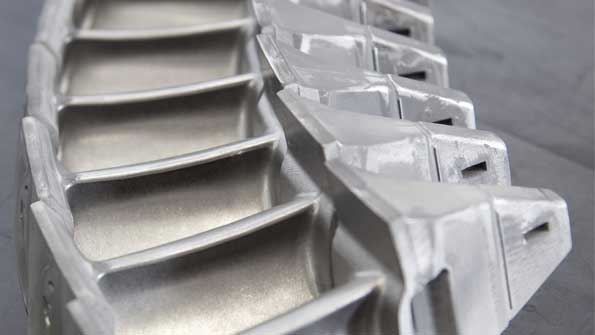

There is competition for those projects: aerospace engineers have shown a willingness to adopt new manufacturing technologies as well as new materials to achieve their goals. Recently, Boeing assigned a purchase order to Norsk Titanium for a supply 3D-printed, structural titanium components for the 787 Dreamliner, produced by a proprietary rapid plasma deposition process. Additive manufacturing, or 3D printing, has become a notable alternative for aerospace engineers, who are impressed with the possibilities for geometrical and structural precision. Also, the 3DP sector has appealed to aerospace engineers with new specialty materials and customized material properties. GE Aviation and other jet-engine developers have been among the most willing adopters of additive manufactured components.

A separate material research project published recently demonstrates what, and how, these efforts can influence aerospace engineering. Researchers at Ohio State University reported they have found a way to “deactivate” microscopic defects (known as “nano twins”) to improve the high-temperature performance of superalloys for turbofan engines. The defects under study form after solidification, as the finished parts are in place and performing the functions they have been custom designed to do — but contribute to structural deformation under heat and pressure. Researchers Michael Mills and Timothy Smith reported that their efforts to customize the alloys’ composition and then expose it to high heat and pressure could show how to prevent nano twins from forming, and even improve the strength of an alloy.
Mills and Smith call their technique “phase transformation strengthening.” In a report published Nature Communications they revealed that they eliminated the formation of nano twins and cut alloy deformation by half. “We found that increasing the concentrations of certain elements in super-alloys inhibits the formation of high-temperature deformation twins, thereby significantly improving the alloys’ high temperature capabilities,” according to Mills a professor of materials science and engineering at OSU.
Their team took a fundamental approach to superalloy design, aiming to address what Mills described as a lack of “quantitative, comprehensive understanding” of how these high-tech materials perform under high stress.
They subjected two superalloys to thousands of pounds of pressure and high heat (1,400°F) to simulate the effects of a jet engine performance, and then examined the alloys’ crystal structures and ran computer models of mechanical behavior at the alloys’ atomic level.
In both alloys, temperature and pressure caused nano twin faults to develop within the superalloy crystals. Further, they found that material composition in and around the faults changed: some elements (e.g., nickel, aluminum) diffused away from the defects, while others diffused into them.
The tendency for particular atoms to diffuse into the nano twin faults depends on the overall composition of the alloy, the researchers found, which creates a new challenge to engineer alloy compositions in order to promote or avoid particular phase transformations.  For the manufacturers that will receive these results and work to put them into action, the changes are no less fundamental.
